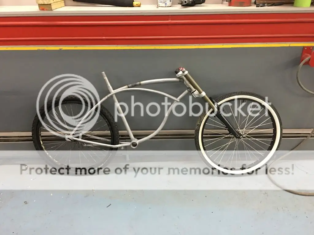

I started building a bike for my gf so she can cruise around town with us but I can't decided on a 79cc or a 49cc 4 stroke kit with a 3 speed hub. What are yours guys opinion?

Gf = girlfriend my friend made the mistake of letting her ride his bike and she was hooked so now I have to build her one since I'm not letting her ride either of mine haha
Lot's more grunt with the 79cc Predator and the price is right. I've used both the 49cc hs and the 79cc and there's a big difference in power. On the other hand the 49cc is narrower and if you have three speeds to work with the smaller engine should be powerful enough. Easier to swap carbs to an NT with the predator. If you're smart you'll leave the decision to your girlfriend... big points for you. Ha!

She's been pretty involved in the decision making so far. She just said she wanted a 4 stroke with a centrifugal clutch and to be able to keep up with my friends and I. Which my three friends and I all have fully built 2 strokes by Fred from Fred head. All three running race gas and then I have the 212 bike so really neither motor will be enough for her. I want her to be able to cruise between 35 and 40.

I'd slap an ungoverned 79 in that frame for her! You can get that up to 35 -40 with ease and it's like the 212's kid brother so you would already know what to do =-)
