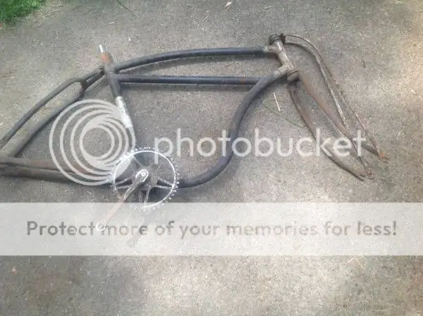

.we.Hello everyone, last night I picked up a cool looking straight bar frame from the local CL, with the intention of using it as my first motor bike build.
I'm starting this thread as a log book of the whole process and I'll updated as progress moves along.
Here's the frame I bought:
From the seller's description, he said it was from the mid 50's. The badge reads Black Knight and it says made in Western Germany.
Seller's pic;
