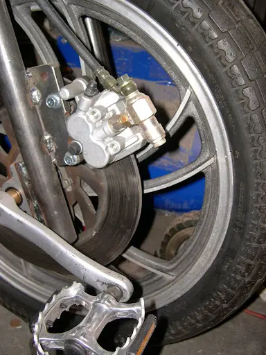

Let me help you a little with the brake issue. I am running a hydraulic disc on the front of the sidehack:
What you want is a scooter brake Master cylinder & calipers.
You do not want a larger master cylinder. Keeping the smaller master gives you more total braking force. Going larger would reduce available braking.
With the scooter front caliper in that picture, you get a pressure limiter. It is the cylinder hanging on the front of the caliper that the hose is attached to. The scooter folks call it "Anti-Lock". It is adjustable, and this is what you would use to proportion your front-to-rear braking force from a single lever.
With that single lever and front caliper I can stop that heavy bike from 30 mph with one finger. The pressure limiter can be adjusted to skid the front wheel - or not.
I chose the brakes with the plan to add a rear caliper if I felt it was necessary. The lever travels about 1/2" at the tip of the lever from rest to full braking. Adding a second caliper might increase the total travel 25%, but would make the braked that much easier to modulate.
Adding a second caliper to the system would require a longer banjo bolt for the master cylinder, something that should not be too hard to find.
By using a pair of calipers with pressure limiters you should be able to balance the braking system. The scooter parts are more robust than bicycle parts, and the single front caliper will stop a 700 pound scooter from 40 mph tothe limits of the tire.
Hope that helps

Yes, I have only the front brake. I was planning a rear, but have not felt I needed it.

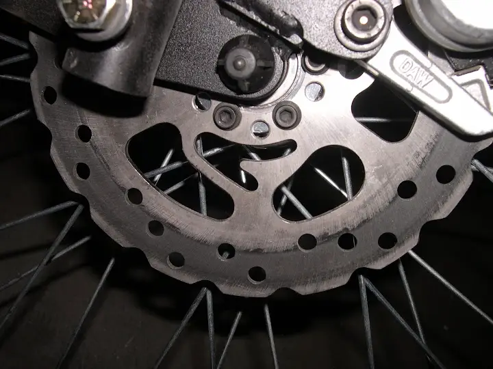

The Big Wheel has a 2 piston caliper, on a 300mm rotor. It is a heavy machine, and the little caliper will lock the 19" motorcycle tire if you use more than two fingers on the lever:
When I put the sidehack together, I was concerned that I was going down to a 180mm brake disc, so I planned for a rear brake. I found a 180mm rotor I thought was a bicycle rotor:
But it was about 1mm thicker, and as you can see I had to re-drill the 6 bolt pattern. If you look at the pad marks on it, I think some of the bicycle rotors might work. As long as the braking surface is mostly round. Bike parts tend to be thin - the spandex crowd worries about grams.
I looked around on e-bay, and found the same rotor I used. Apparently it was used on some sort of scooter:
Scooter brake rotor
while not a direct bolt on, it is beefier than the Avid G2 Rotor, and about the same price.
I know there are some 290mm bike rotors out there, and that would work too. I had to remove a little forging flash from the caliper to clear the spokes - a larger diameter rotor would move the caliper away from the spokes.
