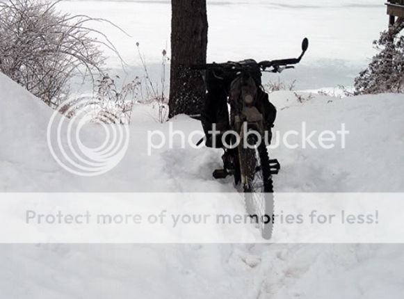

My problem in that extreme weather was that my engine started hard and didn't run very well the whole time. But I have options there. I've been pondering some sort of engine wrap that'll hold in it's heat. Also I'm running a 50 cc that is now nearly two years old, with quite a few miles on it. I have a brand new 80cc waiting for this one to die. Maybe it's time to do an engine swap.

Well, I run an ebike now but I ran an in-frame two smoker for years and the cold should make your engine run better not worse (cold air = denser)... have you checked your plug recently? You may be running a bit too lean due to that air density, I'd not wrap the motor as it should be heating itself just fine, mine had no issues w/cold at all.
I did park it indoors overnight, another potential issue is condensation freeze-up I s'pose if you're leaving it outdoors *shrug* My winter warriors lol;
