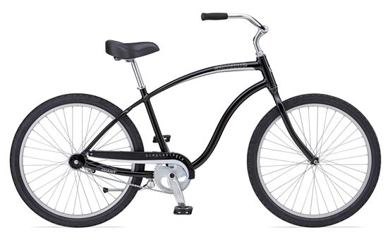

2012 Giant Simple Single: Knowing the quality my 2010 has proven to have, plus the new 2012 frame design with smaller Ø tubing looks like it will work much better with an engine conversion and has me thinking of going this route. The only problem here is the aluminum frame (Giants fancy term is ALUXX). Some say steel frame only and others seem to have converted aluminum frame bikes with no problem. What is your take?

I recomend steel aluminum is a soft metal an prone to work hardening an cracking , also a 5 mile commute is short an should be no problem , I put 30 mi. on mine yesterday just because it can do it .

Steel frames are better because we are going to squeeze the tube with our mounting clamps.
Weight is less of a consideration because we now have power.
In the least, coaster brakes shall fade, in any extended braking action.
Inline rim brakes, (what shimano calls V-brakes), or center pull caliper brakes, are the least I would consider using, if I could not get disk brakes.
I feel having both front, and rear brakes, is very important.
A larger seat is more valuable on a motorized bicycle than on a pedal bike.
(We rarely stand and pedal.)
Front suspension is more important than on a pedal bike, because customary speed is faster, and subsequent impact with pavement irregularities is more treacherous.
A good exhaust muffler is beneficial !

My all time favorite frames are cruisers, maybe because that's what I've grown up with. I've have had other frames, and built MB on them. I had a thin steel frame and the down tube cracked in half. Aluminum isn't any better, in my opinion. Also the tubes crush too easily, so particular attention is needed.
So I stay away from them. You want a frame as close to a 75 degree "V", but you can work around that. Since the cruisers have a curved down tube, I find that a custom front mount is needed, as a engine out of the box won't last long. There are a number of options. Now the coaster brake, at first I had one but changed it for pad brakes, which is easy. Using the coaster set up.
