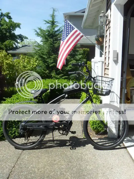

From the left side:

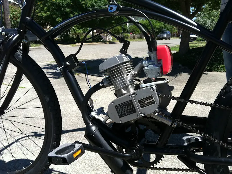

The motor:

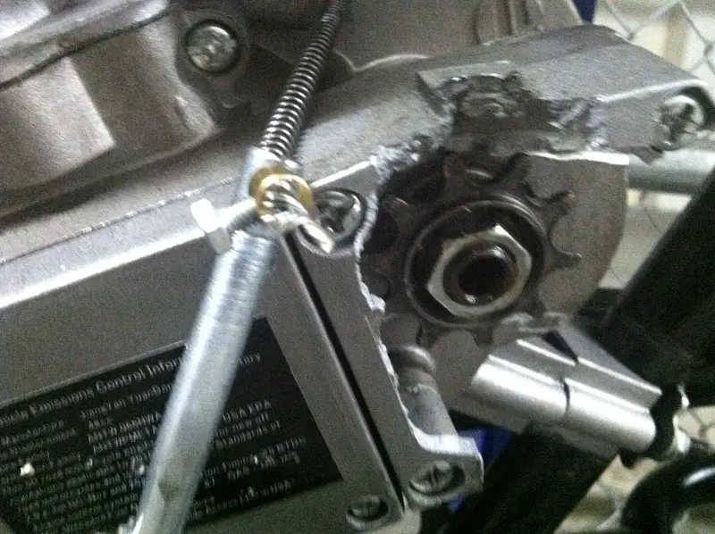

Motor close up:

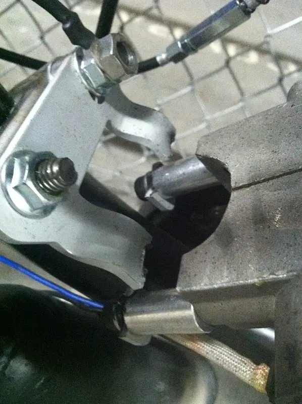

Front mount detail:
