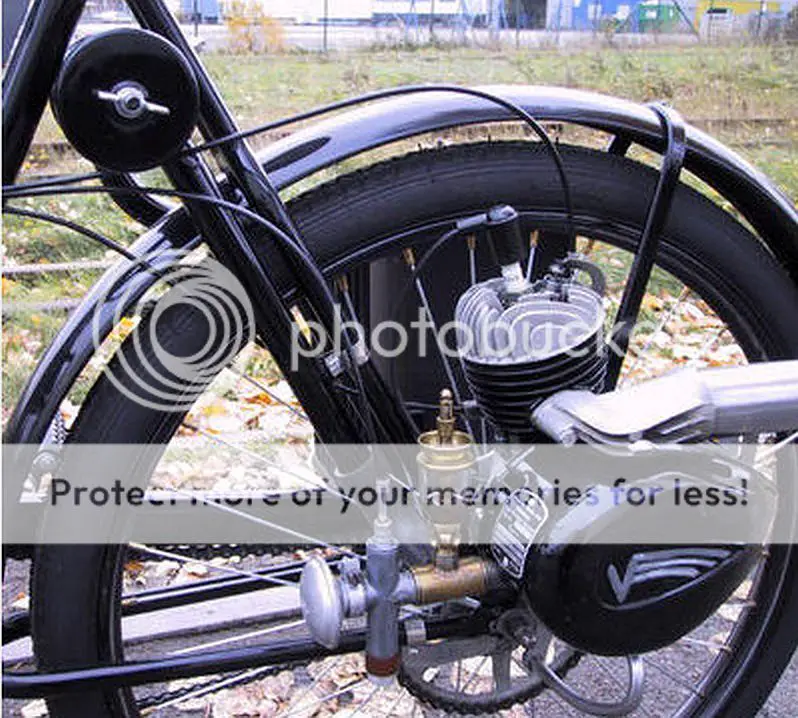

Me being me of course I want to run a Villiers engine on a gasifier and the way around the problem of lubrication is to fit a drip oiler onto the intake manifold. This picture clearly shows how it was done on wartime era two strokes.

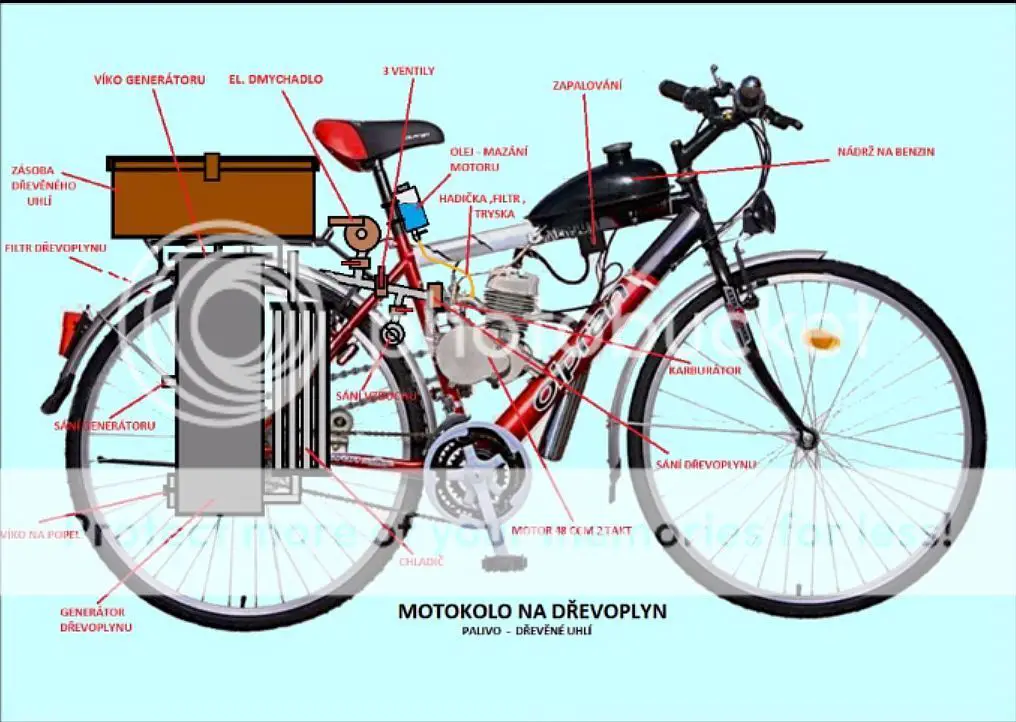

As a point of interest somebody has given thought to running a China Girl on wood gas rather than charcoal as you can see in this diagram. The text is in Czech by the way and I haven't got around to doing a translation.
I have no idea if this setup would work as shown by the way.
