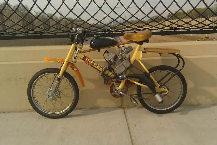

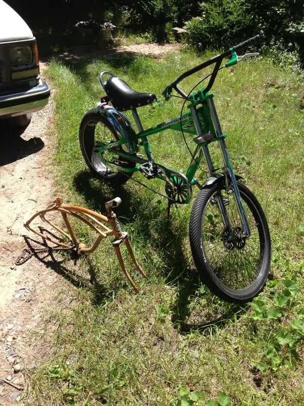

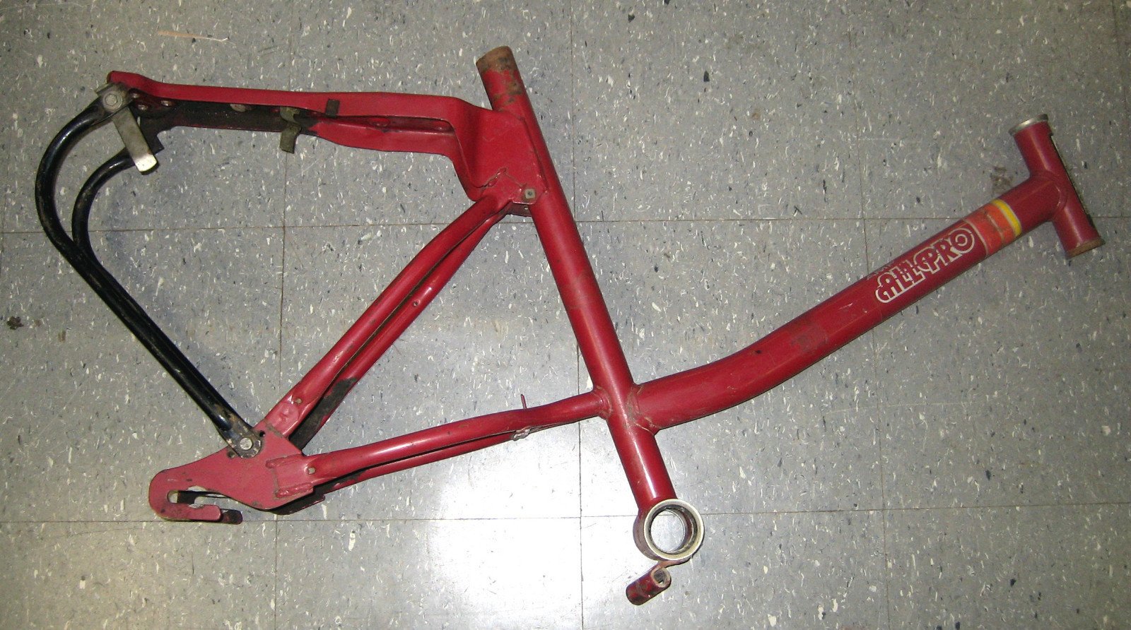

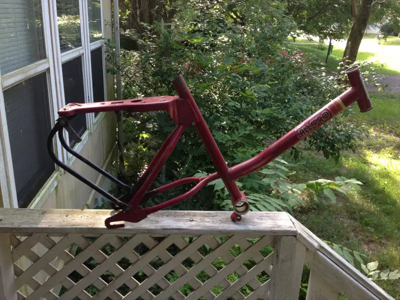

Getting a AMF Roadmaster frame today and I am thinking of motorizing it.
Here is an example, but I want to put it under the tube.
Using the rear wheel and forks from this.

Interesting. Should be a cool bike when you're done. Are you going to go with a rear mount tank? It looks like the one in your example is never going to be able to use more than half a tank of juice no matter what happens due to the angle it's mounted at.

I was thinking of mounting a tank on the down tube like on many mopeds.

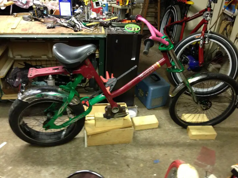

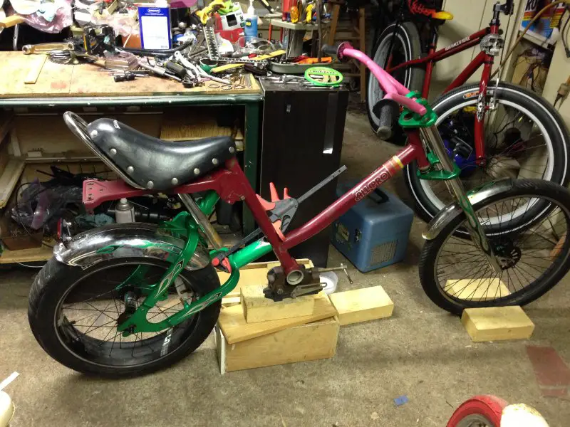

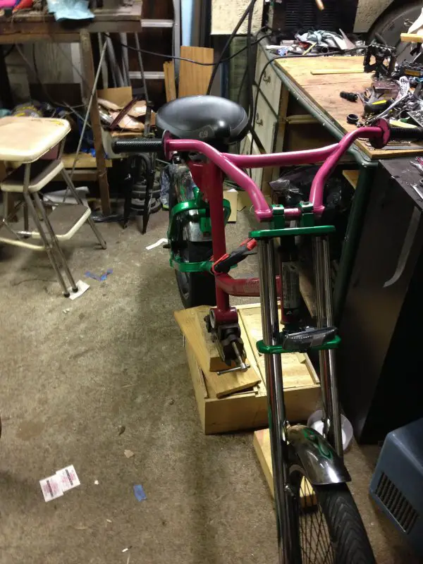

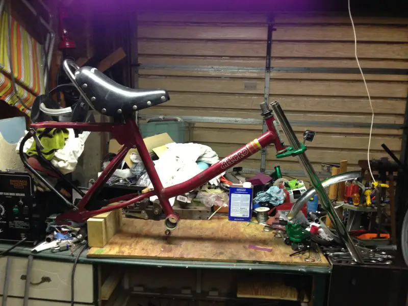

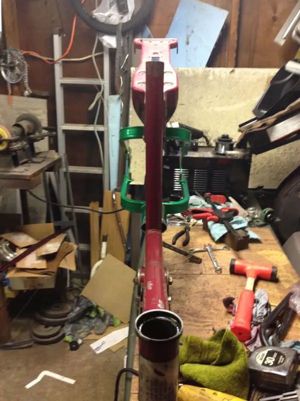

Ok, so I start removing parts from the Schwinn StingRay to test fit them on the AMF frame and at first I think the steer / head tube was going to be the wrong size. Well the only issue I have with it is the length.
You don't see no pink handle bars there, they are not the handle bars you looking for.
I then notice that the seat post is almost the same diameter as the seat tube on the frame, this is just crazy insane.
Looks good in the mock-up pics, it's definately going to be a nice bike when you're done. I wondered because it looks like there's plenty of room under that rear rack to sling a tank, and maybe a battery box for lights too.

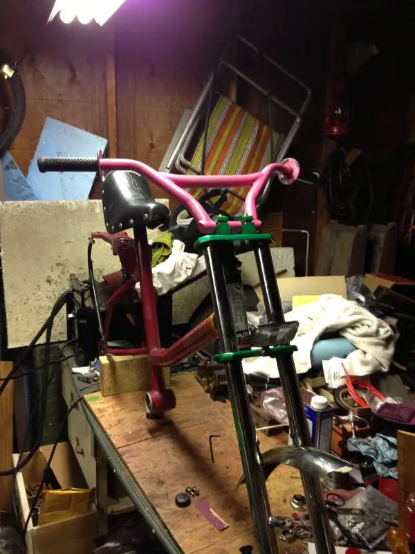

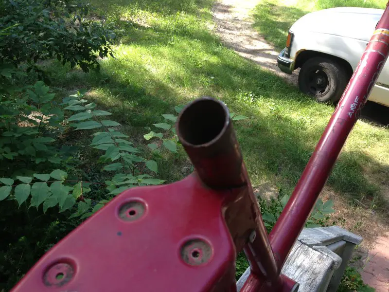

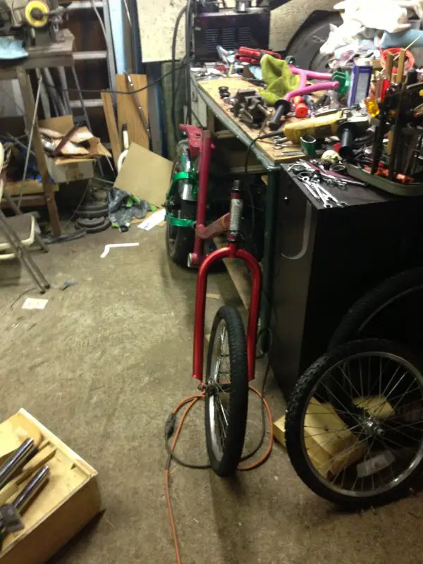

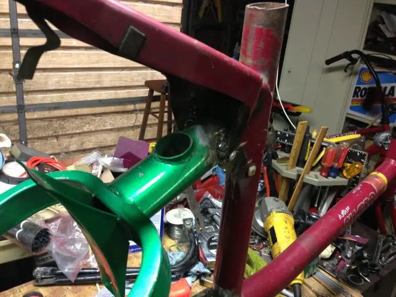

Alright I got the Mad Scientist tools out and started a hacking and grinding away the parts that don't fit.
So here is what popped out of the cutting, hacking and grinding....
Then I had to see what seat might look good on it., still pondering that question.

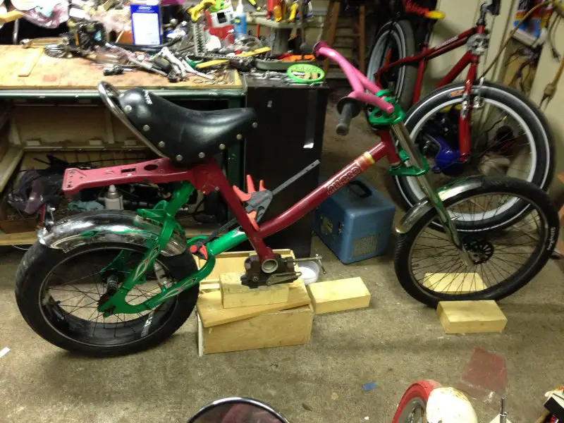

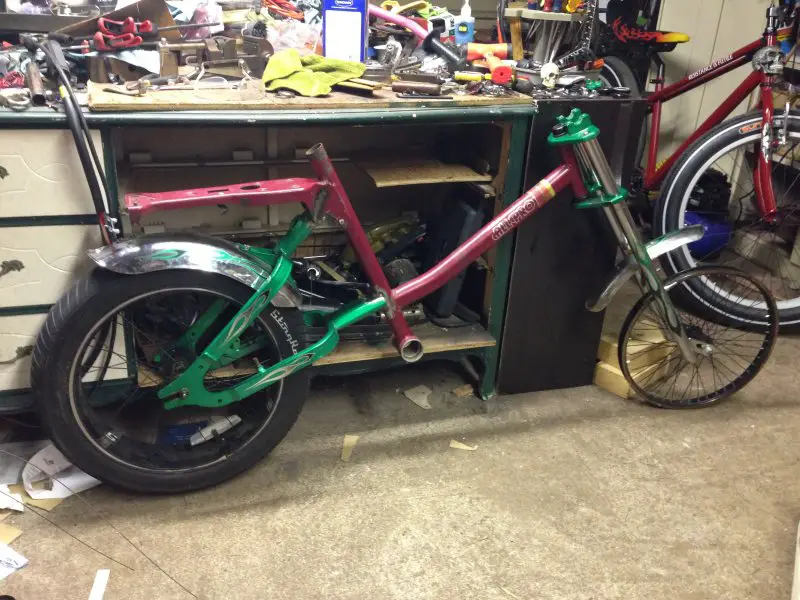

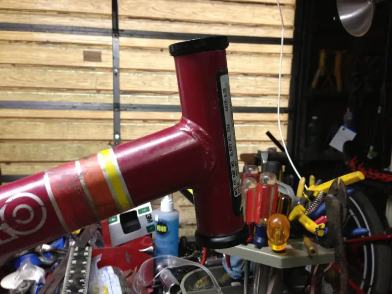

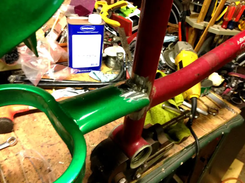

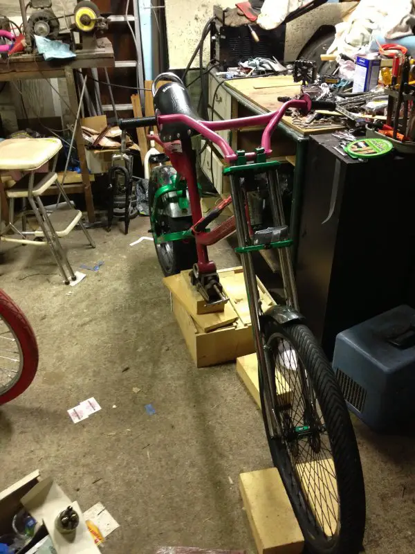

Did some welding today and another Mock up of the bike...
I also switched out the bearing cups for the Head Tube with the ones from the Schwinn. The shocking fact is the AMF head tube is for a 1 1/8" setup and was built back in the 70's like this.

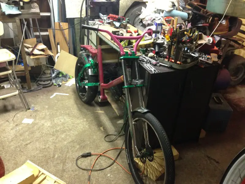

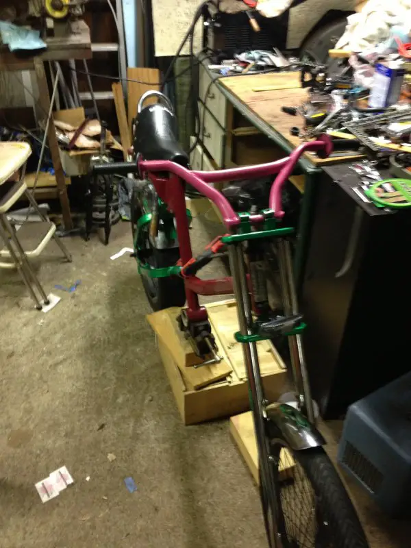

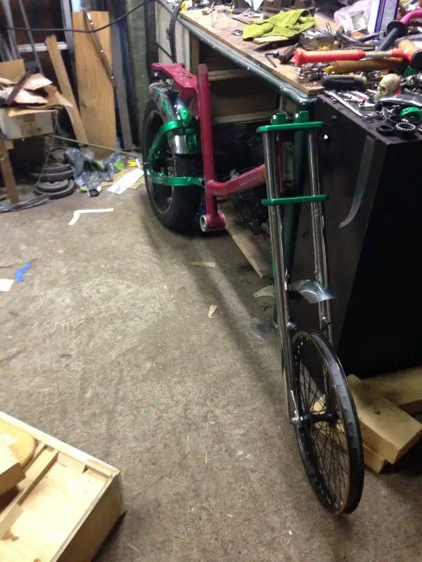

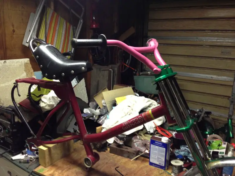

Here is the 3rd Mock up of the bike.
I thought I would see what it would look like with a 20" wheel on the front also. Yes that is a set of forks from a Beast.

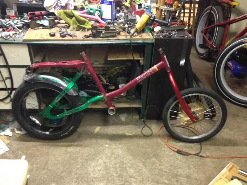

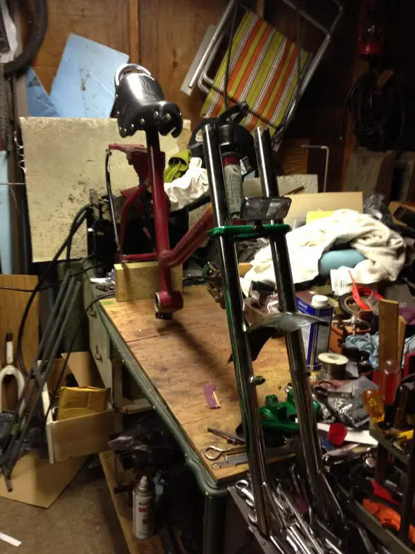

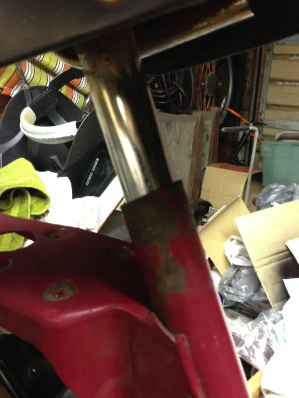

I am still thinking about the 20" wheel, but not totally hooked on it.
I had to cut and weld the steer tube because it was a little over an inch to long. I use a part of a 1" steer tube to slide the two halves together on and to keep it straight.
