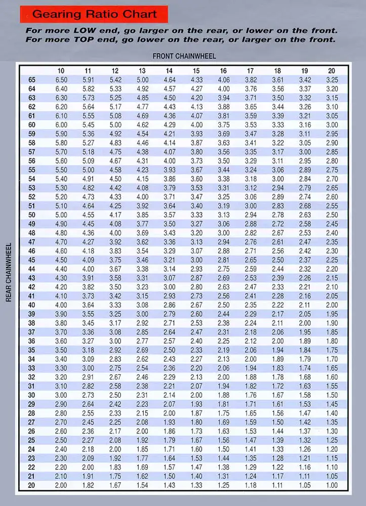

I recently put a 36 tooth sprocket on my MB. I got the 36 tooth because i heard its better?? But then my brother said the bigger the sprocket the faster it is? Does smaller amount of teeth mean more acceleration or something? Whats better Bigger/More teeth OR Smaller/less teeth? Will a 36 tooth sprocket make me less faster? Thanks, Longhorn6
Sprocket Size Chart.
Larger rear sprocket =slower top speed/faster acceleration/pulls more weight/goes up hills better
smaller rear sprocket =Higher top speed/med acceleration/pulls less weight/goes up hills slower
my stock 44t sprocket takes off fast and tops out around 30mph or so and can go up hills good.
a 36t sprocket should give you a higher top speed and lower rpms out of your engine which will make your engine work less and it will make less noise,but will take off slower than with the larger one.
