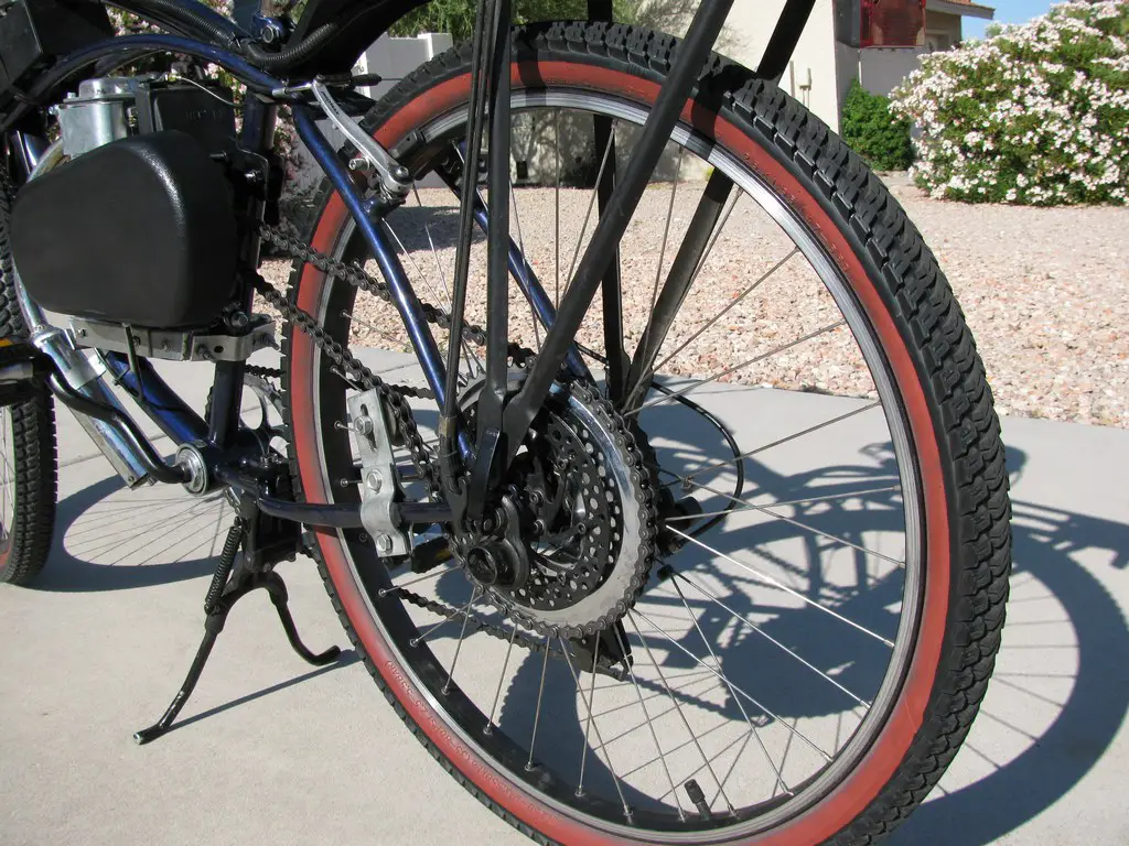

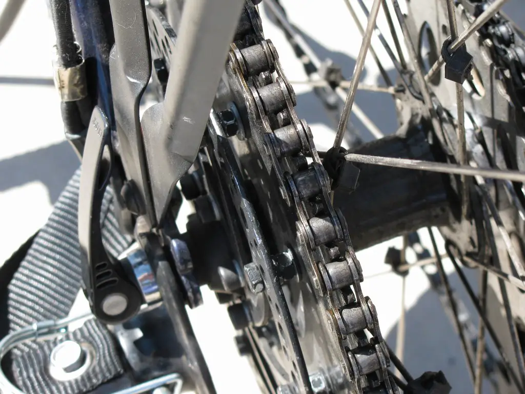

R realdigga New Member Aug 11, 2009 #1 can a drive sprocket be mounted directly onto the disc brake mount or will it cause the chain to hit the frame?
azbill Active Member Aug 11, 2009 #2 it can, but you might need to space it so the chains runs straight Attachments mini-EZ Motorbike sprocket mount close-up.jpg 177.5 KB · Views: 353 mini-May 15 '09 chrome 50 tooth.jpg 257 KB · Views: 300
