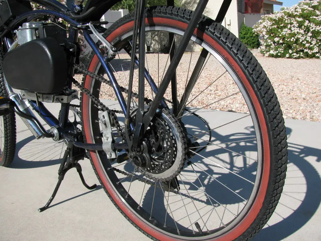

as stated by 2-door,,they have been mounted to disc brake capable wheels
I have over 8000 miles on this wheel, it has been trued once !!!...thanks lennyharp
how-many-options-centered-sprocket-mini-may-15-09-chrome-50
Bill
