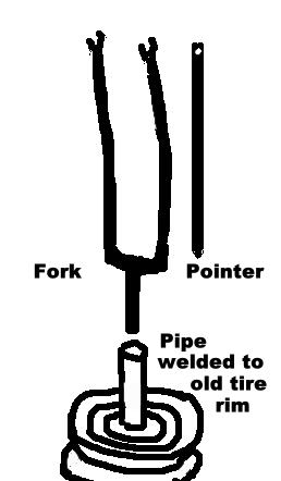

In my experience with broken spokes I keep a pair of diagonal cutters (plires) to cut the spoke at the base on the rim and then pull the wire spoke out of the rim's hub. That at least gets it out of the way so it won't tangle somehow.
Then as soon as I can service it I try to do so. I use an old front fork from a junked bike that's mounted to use as a rim truing stand. I've made metal strips which extend from the axle out to the edge of the rim to index the movement of the rim in and out while rotating from the fixed point. The metal strip goes under the axle nut and when tightened provides a way to measure. Thus I can rotate the rim around in the pivot instead of having to walk around from side to side. Likewise with my frame work stand. The axle of the truing stand is placed at 5 ft above floor level as a convenient eye level working position. It takes up little room and I suspend it from the shop ceiling when done with it. The fork stays in it for storage and I have some small sand bags
with carry handles which lay in the top of the rim for balast. In nice weather I work with it outside. Sweet, simple, and cheap.
