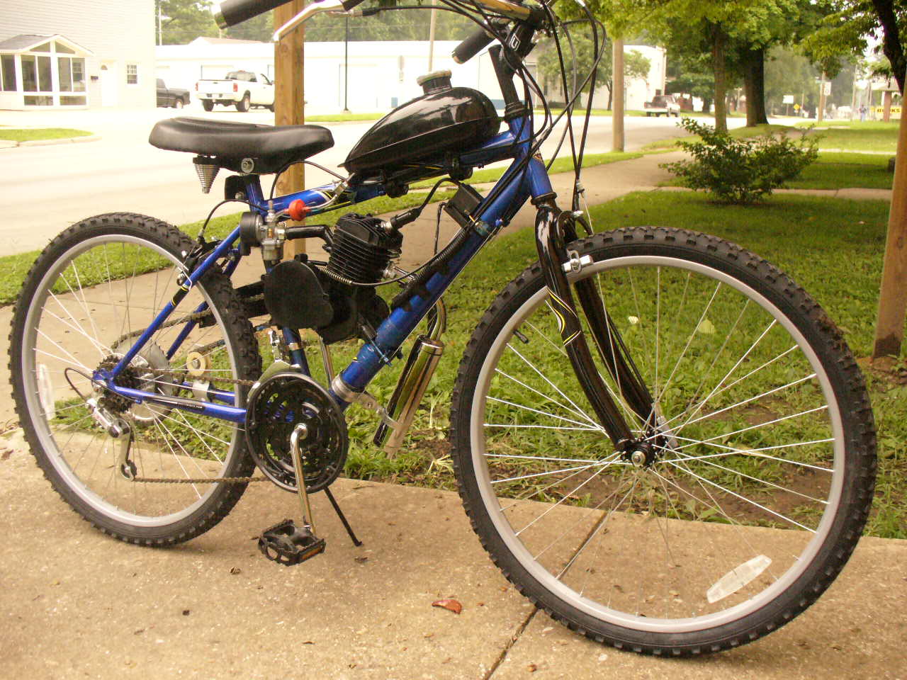

Just started to build this april ,been wanting to build a bike for a couple of years and finally have time at home to do it ,I love these machines ,and they have become my passion ...thanks to all of you who posted here I really appreciate all of your input ,its helped me solve some of the problems I ran across in my construction....

That looks like a great seat on the blue one. Where did you get it?

Nice builds you have there. I'd like to offer some constructive criticism if I may. There have been a number of forum members that have had the stock fenders come loose at the fender/support bracket because of vibration. Please reinforce those places, most have used a heavier L bracket from a hardware store. If you can run the motor drive chain without the slack adjuster the better. Run the slack adjuster on the pedal chain side, there have been problems with it loosening and rotating toward the spokes.

Nice bikes.
Any issues with the intake at that angle on the blue one?

Yea its a great saddle ,very comfortable ...got it on Amazon.com from the section for exercise bikes..its got pretty good springs..and cost only 18.99 plus shipping...great deal!

None so far ..that bike I built for a buddy who really liked my first one...it hasnt seem to make any change in it at all..

Thanks for the advice on the construction...I did build rubber mounts into the fender brackets to cut down vibration noise...with the L bracket where is it mounted on the fender ? any advice is greatly appreciated...thanks

Yes, the L bracket that comes off the brake anchor bolt from the fork. Usually the stock one is pretty thin. A nice thick one from the hardware store will let you sleep better.
Cool bikes, clean work

Thanks for the input.One can put alot of work into these little bikes,but its worth it when someone else likes them too,and so much fun building them

I just seen a picture of the red bike on another thread. That is one nice looking bike, very clean build!!
