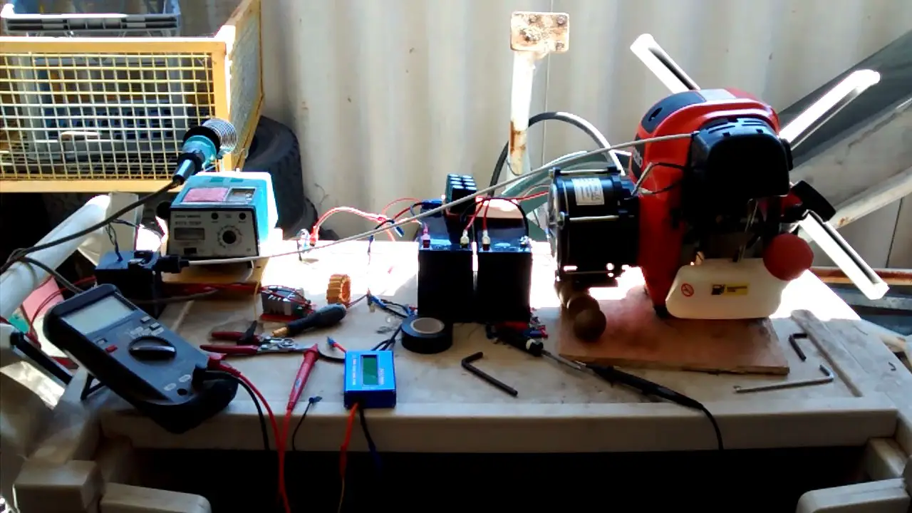

Around Christmas time, I rescued an old petrol bike from a pile of rubbish and rebuilt it, and it's quite a nice bike, but wanted something electric without the range limitations of batteries, so I built my own small-size generator after a few experiments and proof-of-concepts and finally built a prototype and tested it.
The generator was made by coupling a 300w motor to a small 4-stroke engine and using this both to start the motor ( pull start still worked ) and to produce power. All the flanges and shaft components were 3D printed in ABS. 300w isn't much, but the legal limit here in Australia is 200w, so it seemed enough.
After that, I needed an electric bicycle and so set about making one with a 500w 48v kit downrated to 24v.
Testing on the bench seemed to work OK, and so I developed an autothrottle controller to adjust the engine output power to maintain a particular voltage out of the generator, allowing for charging the batteries while in operation. Two SLA batteries provided the power for the motor, and the sink for charging. As voltage from the battery dropped under load, the engine power is increased, with a 1v hysteresis around 24.5 to 25.5 volts ( at least for the test setup ) - This allowed some charging of the battery while providing enough surplus power for the bicycle.
